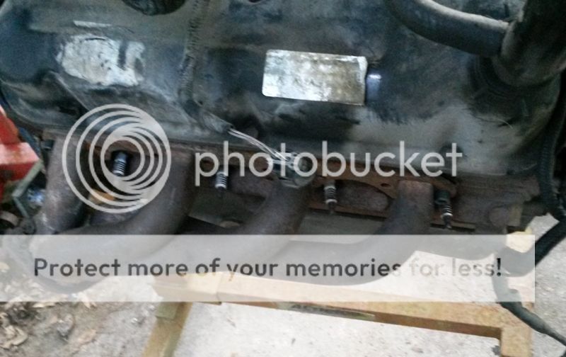

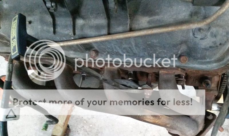

I did the GT40P motor swap on my '79 Zephyr a long time back and had such great success that I am doing it again with my '93 LX I picked up a few weeks ago. That old Zephyr was a real screamer with just a stock HO cam and 1.7 rockers. I used MAC long tubes on it, don't recall exactly which ones but had no issue with plug clearance, just used 90* plug boots.
Here are pics of the plug clearance with the ford racing shorties on my current '00 explorer motor, plenty of clearance just use 90* plug boots on these too.
